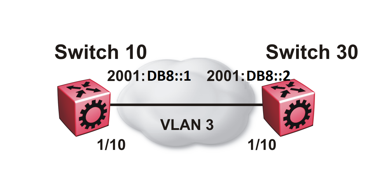

The following displays configuration of IPsec with ICMPv6.
Switch 10 security association configuration
The following example displays the configuration of the security association on Switch 10.
ipsec security-association icmp ipsec security-association icmp encap-proto ESP ipsec security-association icmp mode transport ipsec security-association icmp spi 1 ipsec security-association icmp auth-algo SHA1 auth-key 1234567890123456789012345678901234567890 keyLength 40 ipsec security-association icmp Encrpt-algo AES-CBC EncrptKey 12345678901234567890123456789012 keyLength 32 ipsec security-association icmp key-mode manual ipsec security-association icmp lifetime seconds 1 ipsec security-association icmp lifetime bytes 1
Switch 10 policy configuration
The following example displays the configuration of the security policy on Switch 10.
ipsec policy ICMP_Policy ipsec policy ICMP_Policy admin enable ipsec policy ICMP_Policy raddr 2001::2 ipsec policy ICMP_Policy laddr 2001::1 ipsec policy ICMP_Policy protocol icmpv6 ipsec policy ICMP_Policy action permit ipsec policy ICMP_Policy security-association icmp
Switch 10 interface configuration
The following example displays the configuration of IPsec on slot/port 1/10.
interface gigabitEthernet 1/10 no shut interface vlan 3 interface address 2000::1 interface enable ipv6 ipsec policy ICMP_Policy dir both ipv6 ipsec enable
Switch 10 VLAN configuration
The following example displays the creation and configuration of VLAN 3 with IPsec.
interface gigabitEthernet 1/10 no shut exit vlan create 3 type port-mstprstp 3 vlan members add 3 1/10 portmember interface vlan 3 interface enable interface address 2000::1 ipv6 ipsec policy ICMP_Policy dir both ipv6 ipsec enable
Switch 30 security association configuration
The following example displays the configuration of the security association on Switch 30.
Switch 30 policy configuration
The following example displays the configuration of the security policy on Switch 30.
ipsec policy ICMP_Policy ipsec policy ICMP_Policy admin enable ipsec policy ICMP_Policy raddr 2001::1 ipsec policy ICMP_Policy laddr 2001::2 ipsec policy ICMP_Policy action permit ipsec policy ICMP_Policy protocol icmpv6 ipsec policy ICMP_Policy security-association icmp
Switch 30 interface configuration
interface gigabitEthernet 1/10 no shut ipv6 interface enable ipv6 interface vlan 3 ipv6 interface address 2001::2 ipv6 ipsec policy ICMP_Policy dir both ipv6 ipsec enable
Switch 30 VLAN configuration

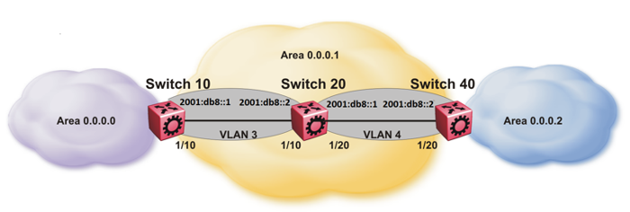

The following example displays a network using IPsec with OSPFv3 virtual link.
The following example displays the configuration of IPsec with OSPFv3 virtual link. For OSPFv3 conceptual and procedural information, see OSPF.
ipsec security-association ospf1 ipsec security-association ospf1 encap-proto ESP ipsec security-association ospf1 mode transport ipsec security-association ospf1 spi 1 ipsec security-association ospf1 auth-algo MD5 auth-key 12345678901234567890123456789012 keyLength 32 ipsec security-association ospf1 Encrpt-algo AES-CTR EncrptKey 12345678901234567890123456789012 keyLength 32 ipsec security-association ospf1 key-mode manual ipsec security-association ospf1 lifetime seconds 1 ipsec security-association ospf1 lifetime bytes 1
Switch 10 OSPFv3 configuration
The following example displays the OSPFv3 configuration on Switch 10.
router ospf ipv6-enable ipv6 forwarding router ospf ipv6 router-id 1.1.1.1 ipv6 area 0.0.0.1 ipv6 as-boundary-router ipv6 area 0.0.0.0
Switch 10 virtual link and policy configuration
The following example displays the configuration of a OSPFv3 virtual link.
ipv6 area virtual-link 0.0.0.1 3.3.3.3 ipv6 area virtual-link 0.0.0.1 3.3.3.3 ipsec ipv6 area virtual-link 0.0.0.1 3.3.3.3 ipsec security-association ospf1 ipv6 area virtual-link 0.0.0.1 3.3.3.3 ipsec action permit ipv6 area virtual-link 0.0.0.1 3.3.3.3 ipsec direction both ipv6 area virtual-link 0.0.0.1 3.3.3.3 ipsec enable
The following example displays the interface configuration on slot/port 1/10.
interface gigabitEthernet 1/10 no shut ipv6 interface vlan 3 ipv6 interface address 2000::1/64 ipv6 interface enable ipv6 ospf area 0.0.0.1 ipv6 ospf enable
The following example displays the creation of VLAN 3 and the configuration of IPsec on VLAN 3.
interface gigabitEthernet 1/10 no shut exit vlan create 3 type port-mstprstp 3 vlan members add 3 1/10 port-member interface vlan 3 ipv6 interface enable ipv6 interface address 2000::1/64 ipv6 ospf area 0.0.0.1 ipv6 ospf enable
Switch 20 OSPFv3 configuration
The following example displays the OSPFv3 configuration on Switch 20.
router ospf ipv6-enable ipv6 forwarding router ospf ipv6 router-id 2.2.2.2 ipv6 area 0.0.0.1
Switch 20 interface configuration
The following example displays the interface configuration on slot/port 1/10 and 1/20.
interface gigabitEthernet 1/10 no shut ipv6 interface vlan 3 ipv6 interface address 2000::2/64 ipv6 interface enable ipv6 ospf area 0.0.0.1 ipv6 ospf enable interface gigabitEthernet 1/20 no shut ipv6 interface vlan 4 ipv6 interface address 2001::1/64 ipv6 interface enable ipv6 ospf area 0.0.0.1 ipv6 ospf enable
Switch 20 VLAN configuration
The following example displays the creation of VLAN 3 and the configuration of IPsec on VLAN 3 and VLAN 4.
interface gigabitEthernet 1/10 no shut exit vlan create 3 type port-mstprstp 0 vlan members add 3 1/10 portmember interface vlan 3 ipv6 interface enable ipv6 interface address 2000::2/64 ipv6 ospf area 0.0.0.1 ipv6 ospf enable interface gigabitEthernet 1/20 no shut exit vlan create 4 type port-mstprstp 0 vlan members add 4 1/20 portmember interface vlan 4 ipv6 interface enable ipv6 interface address 2001::1/64 ipv6 ospf area 0.0.0.1 ipv6 ospf enable
Switch 40 security association configuration
The following example displays the configuration of security associations for OSPFv3 for Switch 40.
Switch 40 OSPFv3 configuration
The following example displays the OSPFv3 configuration on Switch 40.
router ospf ipv6-enable ipv6 forwarding router ospf ipv6 router-id 3.3.3.3 ipv6 area 0.0.0.1 ipv6 area 0.0.0.2 ipv6 as-boundary-router
Switch 40 OSPFv3 virtual link and policy configuration
ipv6 area virtual-link 0.0.0.1 1.1.1.1 ipv6 area virtual-link 0.0.0.1 1.1.1.1 ipsec ipv6 area virtual-link 0.0.0.1 1.1.1.1 ipsec security-association ospf1 ipv6 area virtual-link 0.0.0.1 1.1.1.1 ipsec action permit ipv6 area virtual-link 0.0.0.1 1.1.1.1 ipsec direction both ipv6 area virtual-link 0.0.0.1 1.1.1.1 ipsec enable
Switch 40 interface configuration
The following example displays the interface configuration on slot/port 1/20.
interface gigabitEthernet 1/20 no shut ipv6 interface vlan 4 ipv6 interface address 2001::2/64 ipv6 interface enable ipv6 ospf area 0.0.0.1 ipv6 ospf enable
Switch 40 VLAN interface configuration
The following example displays the creation of VLAN 4 and the configuration of IPsec on VLAN 4.
interface gigabitEthernet 1/20 no shut exit vlan create 4 type port-mstprstp 0 vlan members add 4 1/20 interface vlan 4 ipv6 interface enable ipv6 interface address 2001::2/64 ipv6 ospf area 0.0.0.1 ipv6 ospf enable

Switch 10 IPsec policy configuration
The following example displays the configuration of the IPsec policy for TCP for Switch 10.
ipsec policy tcp1 ipsec policy tcp1 admin enable ipsec policy tcp1 raddr 2000::2 ipsec policy tcp1 raddr 2000::2 laddr 2000::1 ipsec policy tcp1 raddr 2000::2 protocol tcp sport 23 dport 23 ipsec policy tcp1 raddr 2000::2 action permit
Switch 10 linking the IPsec policy with the IPsec security association
The following example displays the linking of the IPsec policy with the IPsec security association
ipsec policy tcp1 security-association tcp1
The following examples displays the configuration of IPsec for slot/port 1/10.
interface gigabitEthernet 1/10 no shut ipv6 interface vlan 3 ipv6 interface address 2000::1/64 ipv6 interface enable ipv6 ipsec policy tcp1 dir both ipv6 ipsec enable
The following example displays the creation and configuration of VLAN 3.
interface gigabitEthernet 1/10 no shut exit vlan create 3 type port-mstprstp 3 vlan members add 3 1/10 portmember interface vlan 3 ipv6 interface enable ipv6 interface address 2000::1/64 ipv6 ipsec policy tcp1 dir both ipv6 ipsec enable
Switch 30 IPsec security association configuration
The following example displays the configuration of the IPsec security association for TCP for Switch 10.
ipsec security-association tcp1 ipsec security-association tcp1 encap-proto ESP ipsec security-association tcp1 mode transport ipsec security-association tcp1 spi 100 ipsec security-association tcp1 auth-algo MD5 auth-key 12345678901234567890123456789012 keyLength 32 ipsec security-association tcp1 Encrpt-algo AES-CTR EncrptKey 12345678901234567890123456789012 keyLength 32 ipsec security-association tcp1 key-mode manual ipsec security-association tcp1 lifetime seconds 1 ipsec security-association tcp1 lifetime bytes 1
Switch 30 IPsec policy configuration
ipsec policy tcp1 ipsec policy tcp1 admin enable ipsec policy tcp1 raddr 2000::1 ipsec policy tcp1 raddr 2000::1 laddr 2000::2 ipsec policy tcp1 raddr 2000::1 protocol tcp sport 23 dport 23 ipsec policy tcp1 raddr 2000::1 action permit
Switch 30 linking the IPsec policy with the IPsec security association
interface gigabitEthernet 1/10 no shut ipv6 interface vlan 3 ipv6 interface address 2000::2/64 ipv6 interface enable ipv6 ipsec policy tcp1 dir both ipv6 ipsec enable
interface gigabitEthernet 1/10 no shut exit vlan create 3 type port-mstprstp 3 vlan members add 3 1/10 portmember interface vlan 3 ipv6 interface enable ipv6 interface address 2000::2/64 ipv6 ipsec policy tcp1 dir both ipv6 ipsec enable
